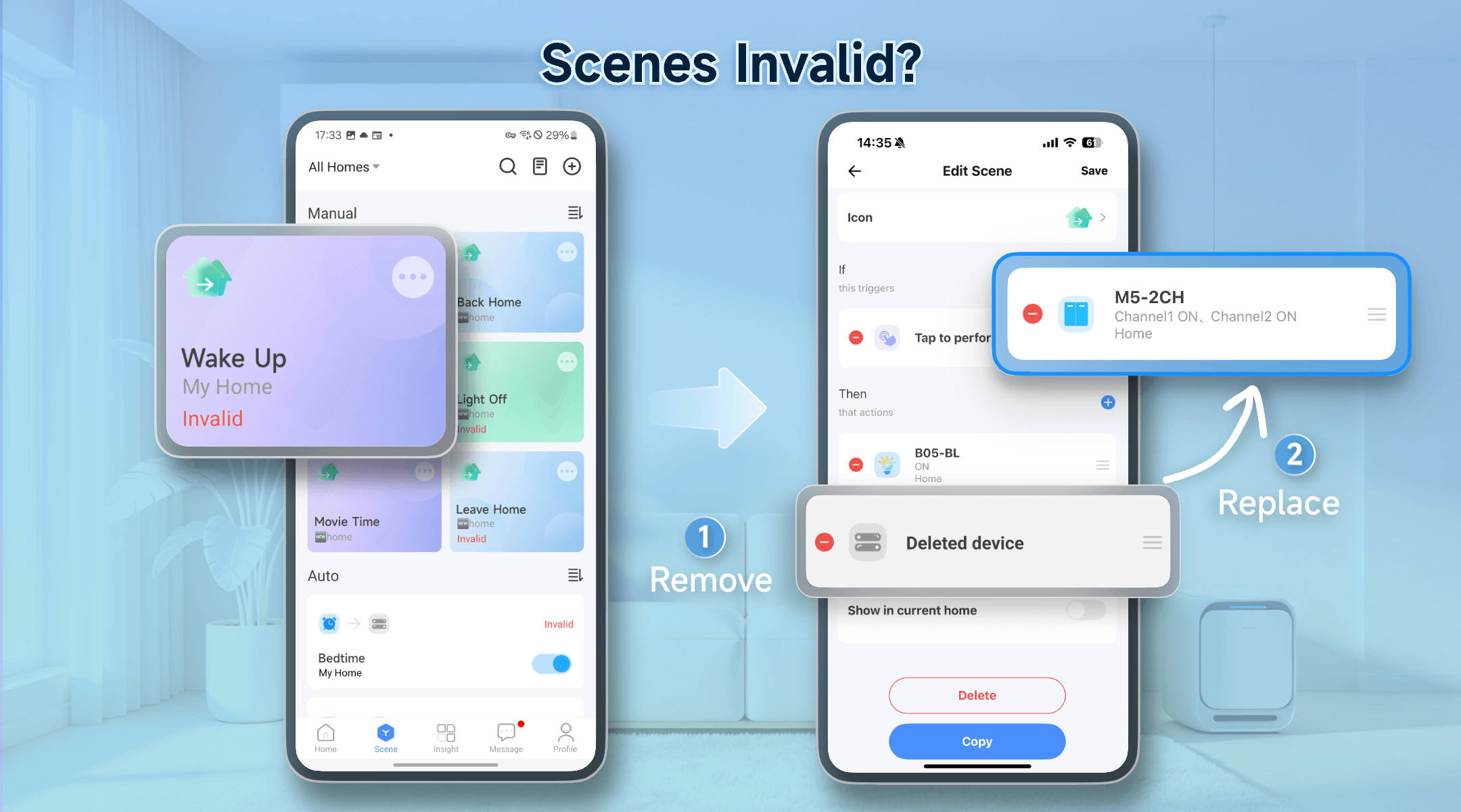

Restore or Update Your Scenes
Once you have identified the broken scenes, instead of rebuilding repeatedly, the solution depends on whether the device was removed by mistake or if you intended to replace it.
Path 1: If the device was deleted by mistake
If you accidentally deleted a device, you don’t need to rebuild your scenes from scratch.
- Re-add the device: Add the device back to your eWeLink account.
- System Repair: Pull-down to refresh your scene list. The broken scenes will automatically be restored.
- Reactivate (if necessary): If the scene was fully broken, it may remain disabled for safety. Simply toggle the scene back to enabled. If it were only partially affected, it would resume normal operation automatically.
Path 2: If the device was intentionally removed or replaced
If you have upgraded your hardware or removed a device intentionally, you can update your scene to keep it running.
- Open the scene: Tap the Invalid scene to open its edit page.
- Review the broken device: You will see the deleted device icon grayed out in your trigger or action list. This clearly indicates which part of the logic is currently unavailable.
- Update the logic: Tap the “-” icon to remove the deleted device permanently, then re-add or replace it with a newly added device.
- Save and test: Save the changes and test the scene to ensure it performs as expected.
