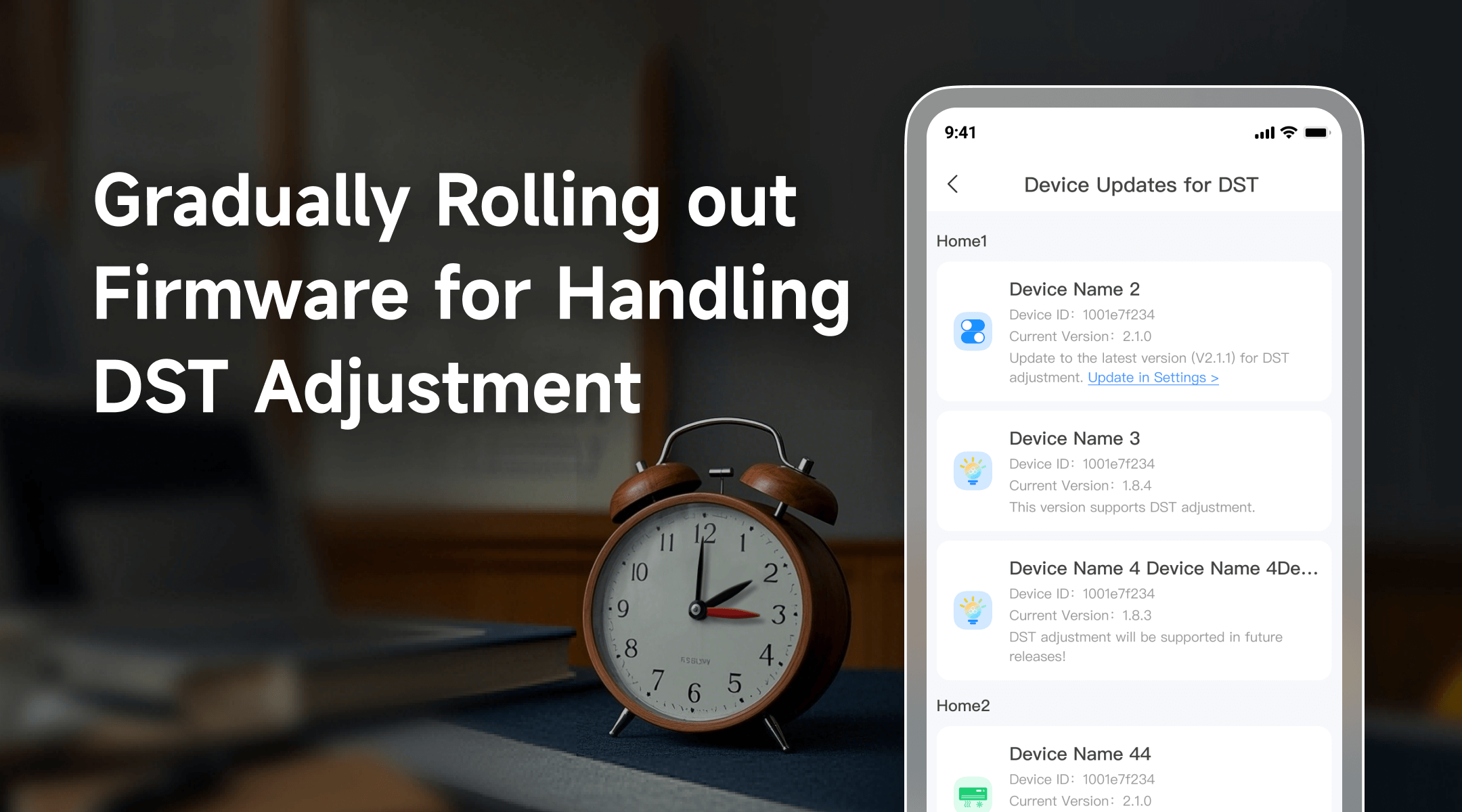

That’s exactly what we’re aiming to fix! We are deeply aware of that. Starting March 2025, firmware updates will gradually roll out to eligible devices to automatically handle DST changes. Once updated, your devices will perform more reliably during DST transitions. Here’s how to get your devices ready:

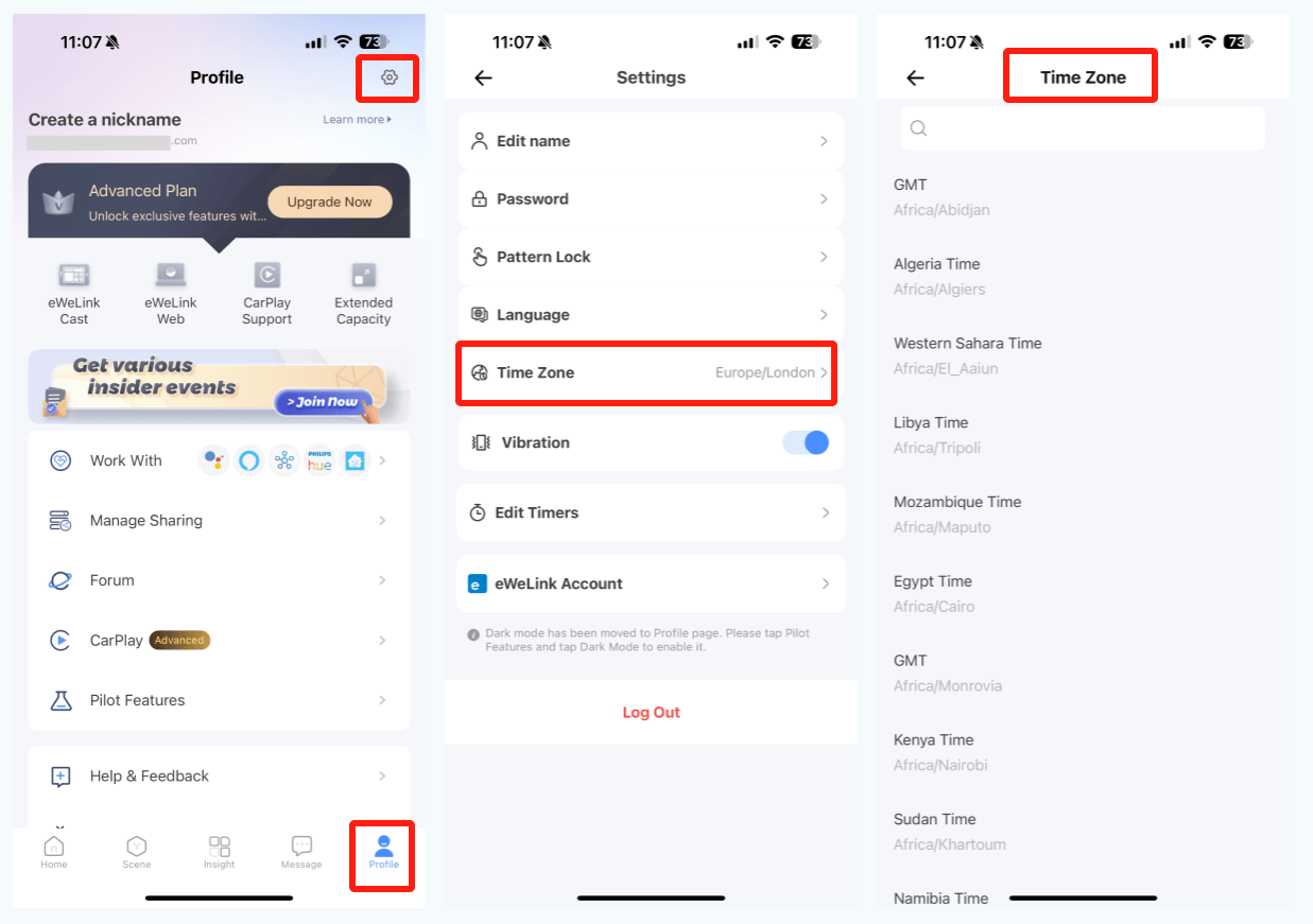

2. Check Your Time Zone Settings
Go to Profile > Settings > Time Zone and check that your time zone is set as you want.

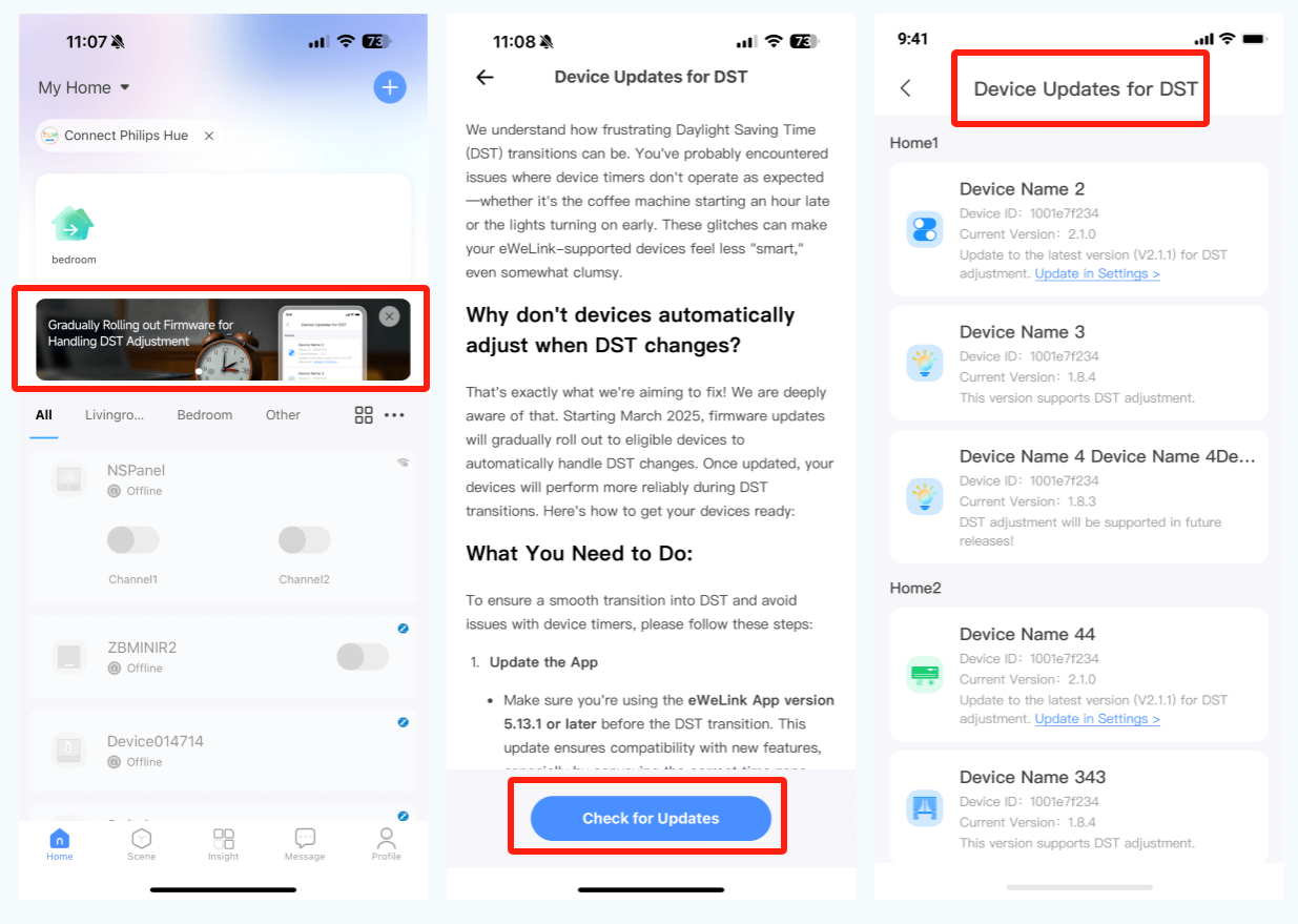

3. Update Your Device Firmware
Visit the eWeLink home page and click on the banner to check for available firmware updates.
Effortless Firmware Updates with eWeLink Web
Keeping your smart devices up to date is crucial for optimal performance, but updating each device manually can be time-consuming. With eWeLink Web, you can upgrade multiple supported devices at once directly from the Firmware Update page.
If your devices support the latest firmware updates, log in to eWeLink Web, navigate to the Firmware Update page, and streamline your update process.
