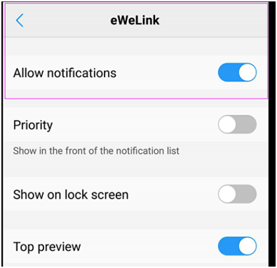

2. Enter the settings of your mobile device and check if you have given all the permissions to eWeLink app. See the pic below.

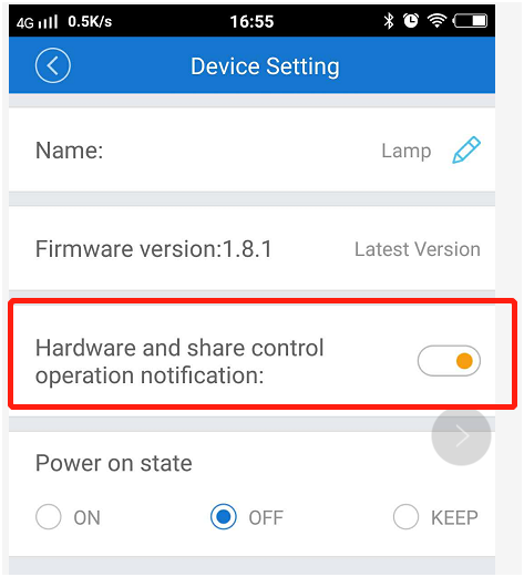

3. Open ‘EWeLink’ app, tap ‘Device Setting’ , enable ‘Operation notification’ and switch on ‘Allow notifications’. See the pic below.
